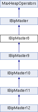

IBipMaster8 Class Reference
IBipMaster8 Class Referenceabstract
#include <Biped8Api.h>
Class Description
Interface into the biped master controller for Max 8.
This contains functions supporting new biped features in Max 8. These include euler versus quaternion rotations, locked com, twist bones, twist poses, bend links functions, and copy collections.
+ Inheritance diagram for IBipMaster8:
