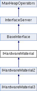

+ Inheritance diagram for IHardwareMaterial:
