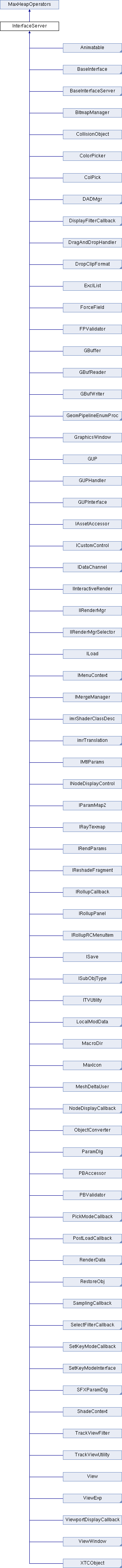

+ Inheritance diagram for InterfaceServer:
