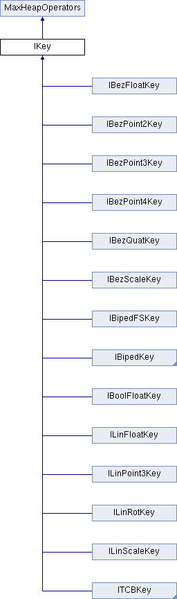

+ Inheritance diagram for IKey:
Public Member Functions
 IKey ()
Public Attributes
TimeValue time
DWORD flags
