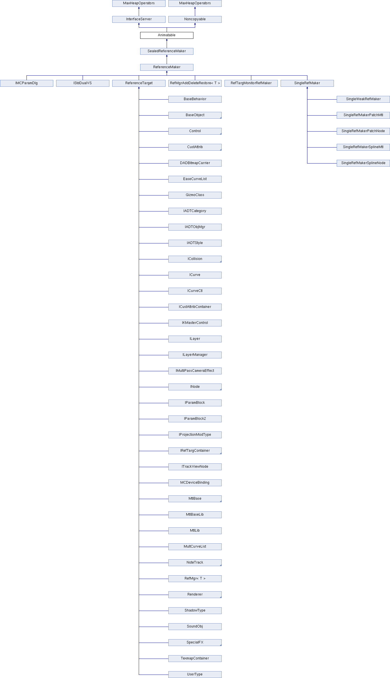

Inheritance diagram for Animatable:Classes | |
