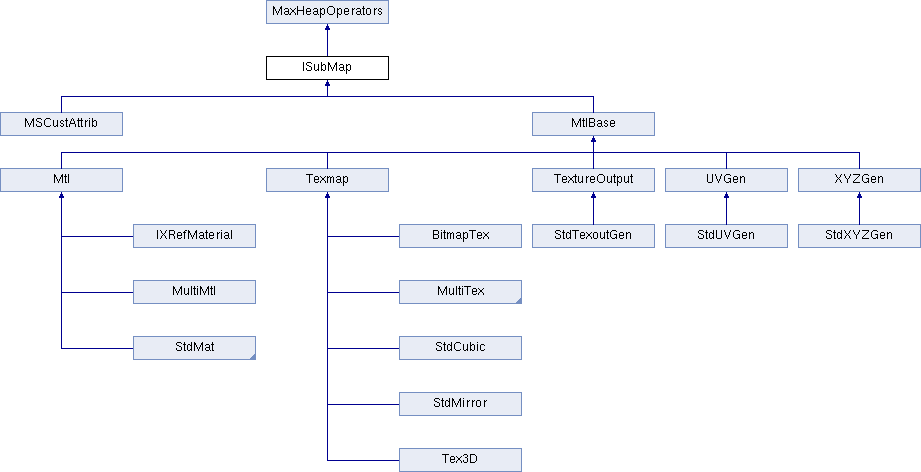

The methods of this class provide access to the sub-textures of a MtlBase. These properties include the number of sub-maps, the slot type, on / off state, etc.
The MtlBase class sub-classes from this class. If a developer is creating a plug-in derived from MtlBase (for instance a Material or Texture) then implementations of these methods are required. Developers may call these methods on an existing MtlBase sub-class.
+ Inheritance diagram for ISubMap:
