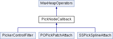

+ Inheritance diagram for PickNodeCallback:
