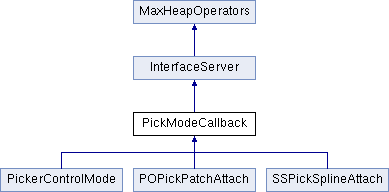

This class is the callback object passed to Interface::SetPickMode().
+ Inheritance diagram for PickModeCallback:
