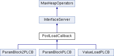

+ Inheritance diagram for PostLoadCallback:

- Public Member Functions inherited from InterfaceServer
virtual UtilExport ~InterfaceServer ()
 Destructor. More...
virtual UtilExport BaseInterfaceGetInterface (Interface_ID id)
Additional Inherited Members
- Static Public Member Functions inherited from MaxHeapOperators

Implemented in ParamBlock2PLCB, ParamBlockPLCB, and ValueLoadPLCB.
