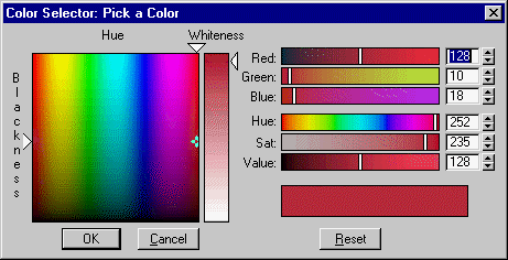

This method puts up the modal HSV color picker dialog box. This dialog appears below:
