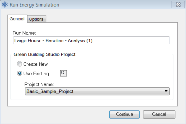

When running an energy simulation for a Revit model, specify the Green Building Studio project to use for analysis settings.
When you use a Revit model as the basis for energy analysis, the energy analytical model is packaged in a gbXML file and sent to Autodesk Green Building Studio for analysis.
Green Building Studio uses the concept of a project as a means of storing simulation runs for your model. The GBS project defines the building type, location, project operation schedule, and other information that is used for the simulation.
Energy Analysis panel
(Run Energy Simulation).
An exception to this is HVAC systems specified for the Revit model. If you change the value of HVAC System in the Energy Model - Building Services section of the Energy Settings dialog, those changes are used in the GBS project for an energy simulation even if you select Use Existing. (Energy analysis does not use information from the Building Service parameter in the Detailed Model section of the Energy Settings dialog.)
