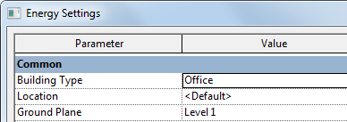

Specify Building Type and Location
Click Analyze tab Energy Analysis panel Energy Settings. In the Energy Settings dialog:
