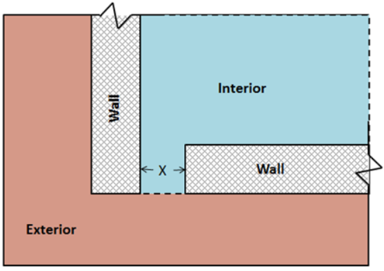

Analytical Space Resolution
This is the primary parameter that influences the EAM accuracy and processing time. This value essentially defines the minimum gap distance between Revit elements that will be ignored in the identification of EAM spaces. Given how the algorithm works, the maximum distance between Revit elements which may be ignored in the identification of EAM spaces is 2 times the Analytical Space Resolution setting. This concept can be illustrated as follows:
Plan view of 2 walls bounding an interior space with a gap between them of dimension X
If Analytical Space Resolution = 1' 6" then:
Note: Default value = 1' 6"
Minimum value = 6"
Maximum value = 10'

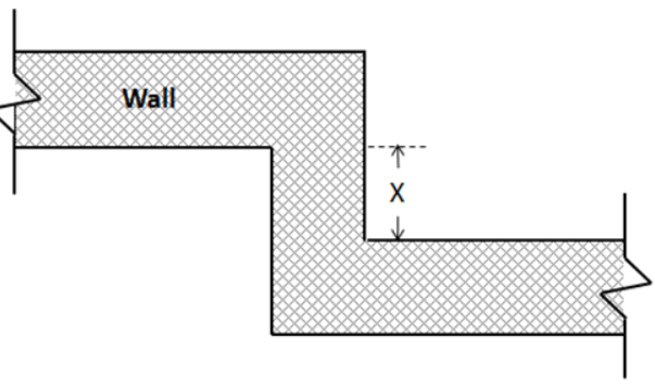

Analytical Surface Resolution
This parameter essentially drives the ability of the algorithm to find individual analytical surfaces. This parameter should be less than the smallest dimension of any surface you wish to be included in the EAM. This concept can be illustrated as follows:
Plan view of a wall with a section of dimension
If Analytical Surface Resolution = 1' then:
