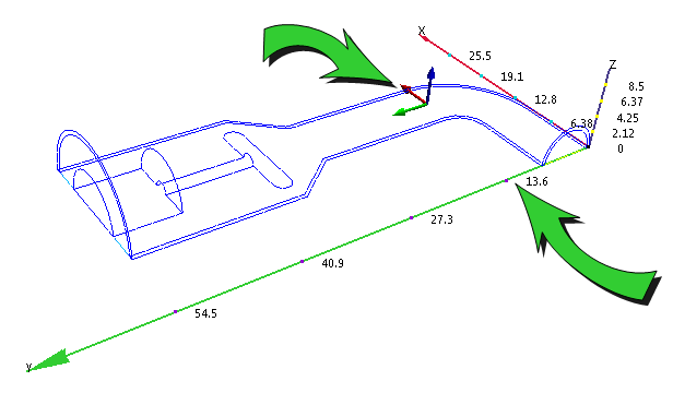

Click Axes to toggle the display of the model coordinate axis and the axis bounding box.
The value in the adjacent field is the number of axis increments. Change this number with the arrows to the right of the field.

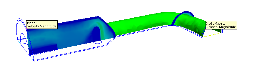

Results Tags
Toggle the display of Planes and Iso Surface tags:
Tags add textual detail to the view. Use them to clarify the displayed results.
The number in the label is the ID shown in the Selection List.
