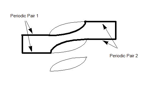

Periodic
Periodic boundary conditions (cyclic symmetry) enable the simulation of a single passage of an axial or centrifugal turbomachine or of a non-rotating device with repeating features (passages).
Periodic boundaries are always applied in pairs; the two members of a periodic pair have identical flow distributions, and must be geometrically similar.
Periodic pairs are used at the inlet and outlets of repeating devices:
To assign a Periodic condition to Pair 1:
  1. Select the first surface of pair 1.
  2. Set the Pair ID to 1 and the Side ID to 1.
  3. Click Apply.
  4. Select the second surface of Pair 1.
  5. Set the Pair ID to 1 and Side ID to 2.
  6. Click Apply.
Repeat for the remaining pairs.
Periodic boundary conditions are a convenient way to include the effect of multiple repeating features in a simplified model. Because of the repeating geometry, the flow upstream and downstream of a device will be the same for each passage.
Note: Mesh Enhancement is automatically disabled when Periodic boundary conditions are applied. This is done to improve solution stability. To enable Mesh Enhancement, open the Mesh quick edit dialog, and click the Enhancement button, and check the Enable mesh enhancement box.
