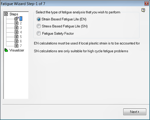

In Step 1 of Fatigue Wizard, select a form of fatigue analysis to perform. You can perform damage based fatigue life calculations, or a fatigue safety factor calculation.
For a description of the different analysis methods, click the hyperlinks that follow, or see the Theoretical Overview section of the Fatigue Wizard Help.
