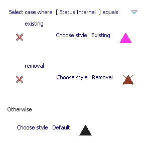

    For example, to create a Style rule that applies styles to transformers based on their status (Existing, Removal), navigate to StyleElectricTransformer.
  3. Right-click the feature class and click Create Rule.
  4. Define the rule as needed.
  5. The rule for styling transformers based on their status might look like this:

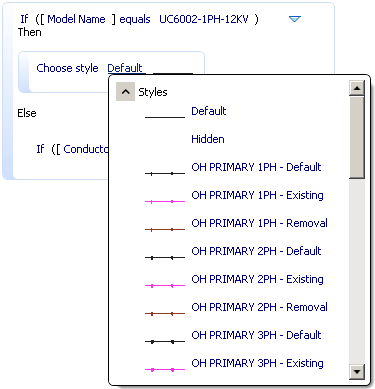

    The rule for styling conductors based on their models might look like this:
