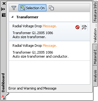

  1. Position the pointer over the result to address.
    If available, the options Ignore This Item and Resolve This Item are displayed.
  2. If the validation result will be addressed later in the workflow, you can choose to ignore the message. Click .
    The message will be hidden and cleared when the issue is resolved.
  3. If a suggested resolution is available, click and then click the desired resolution.
    For example, a suggested resolution for a transformer validation result might be to specify either Radial or Loop as the type of network.
  4. Use the Selection On and Selection Off toggle to control highlighting of the feature related to the selected validation result.
  5. To address all results at once, click Resolve All Items.
