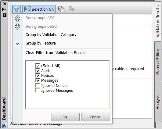

To Sort Validation Results
  1. In the Dashboard, on the Validation Results palette, click Filtering, Grouping, and Sorting .
  2. To change the sort order or how results are organized, click any of the sort and group options.
    You can reverse the sort order of groups and organize results by validation type (Error, Warning, and so forth) or by feature.
  3. To filter the list of validation results, select the checkbox for the type of validation results to display.
    These checkboxes also control the type of validations displayed in the drawing when Show Validations is selected.
  4. To display all results, click Clear Filter From Validation Results.
