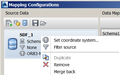

Define mappings between feature classes in the industry model or non-industry model source to corresponding feature classes and attribute values in the current industry model. You can apply filters to the sources to convert only the data of interest from each source. You can apply different filters to the same source as needed. You can also change the coordinate system for the source. You can save mappings and load previously defined mappings.
You can connect to multiple data sources but must specify a single data source for merge back.
