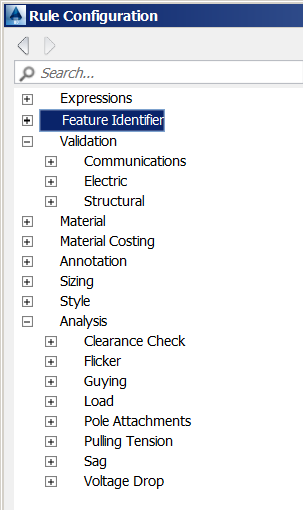

To Display Rule Points
  1. Click Configuration tabSetup panelManage Rules.
  2. View the rule points on the left panel of the Rule Configuration dialog box.
  3. Expand the categories and click a rule point.
    Specific settings are displayed in the rule editing area.
    In the Rule Configuration dialog box, you can easily navigate to subrule definitions. Position the cursor over the subrule and then click Go To Definition. The definition is displayed. Use the Back and Forward buttons to navigate in the Rule Configuration dialog box.
