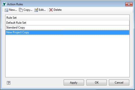

  1. Click the Master Menu on the toolbar and select Action Rules to open the Action Rules dialog.
  2. Click New to Define an Action Rule Set.
  3. Select an existing rule set and click Copy to create a new rule set with the same conditions and property settings.
  4. Select an existing rule set and click Edit to make changes to the existing conditions and property settings.
  5. Select a rule set and click Delete to remove it entirely from the Action Rules list.
  6. Click OK to save your changes.
