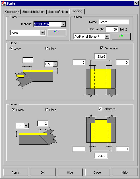

Use the options on the Landing tab to define landing parameters.
Under Plate, select a Material and Family. Families available on the selection list are those defined in the Family Manager dialog. To add a family to the list, click
. The Family manager dialog displays, in which you can select a family.
Under Grate, specify a Name, a Unit weight, and a Family type. Families available on the selection list are those defined in the Family Manager dialog. To add a family to the list, click
. The Family manager dialog displays, where you can select a family.
Define parameters of the upper and/or lower landing(s):
o Landing thickness, and the landing extension for the lower landing
o Landing width, and the landing extensions to the sides in both directions
The following buttons are located at the bottom of the dialog:
