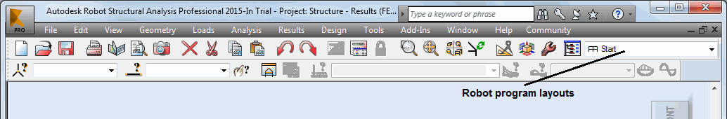

Define, calculate and design your structure using the consecutive layouts available the Layouts drop-down list.
The Layouts list contains several types of layouts group under headings. Options found in the structure Model group are shown in the image below. All other option groups are collapsed to avoid an excessively long layout list.

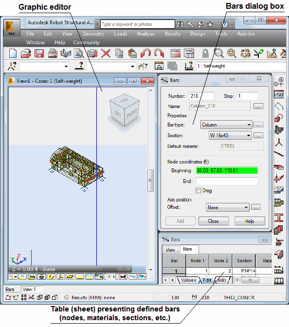

As an example of using layouts, this screen arrangement opens after choosing the Bars layout. Please note, for better legibility, this image does not show the Object Inspector dialog.
The screen has three distinct parts:
