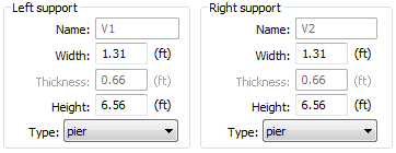

Depending on a selected calculation method, the lower part of the dialog box, concerned with support definition, varies.
In case of calculations by means of FEM, the user may choose the following types of supports from the drop-down list in the lower part of the dialog box:
Moreover, the dialog box comprises fields for definition of support dimensions. Depending on a selected support type, the user may define:
Detailed data concerning the method of modeling the support conditions in FEM are given in the topic Principles of deep-beam modeling by means of FEM - Modeling of support conditions of a membrane.

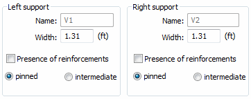

In case of calculations by means of the BAEL simplified method the user may choose one of the following two types of supports:
Apart from that, a support width should be defined.
