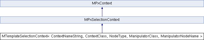

+ Inheritance diagram for MTemplateSelectionContext< ContextNameString, ContextClass, NodeType, ManipulatorClass, ManipulatorNodeName >:
