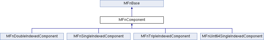

Inheritance diagram for MFnComponent:Public Member Functions | |
