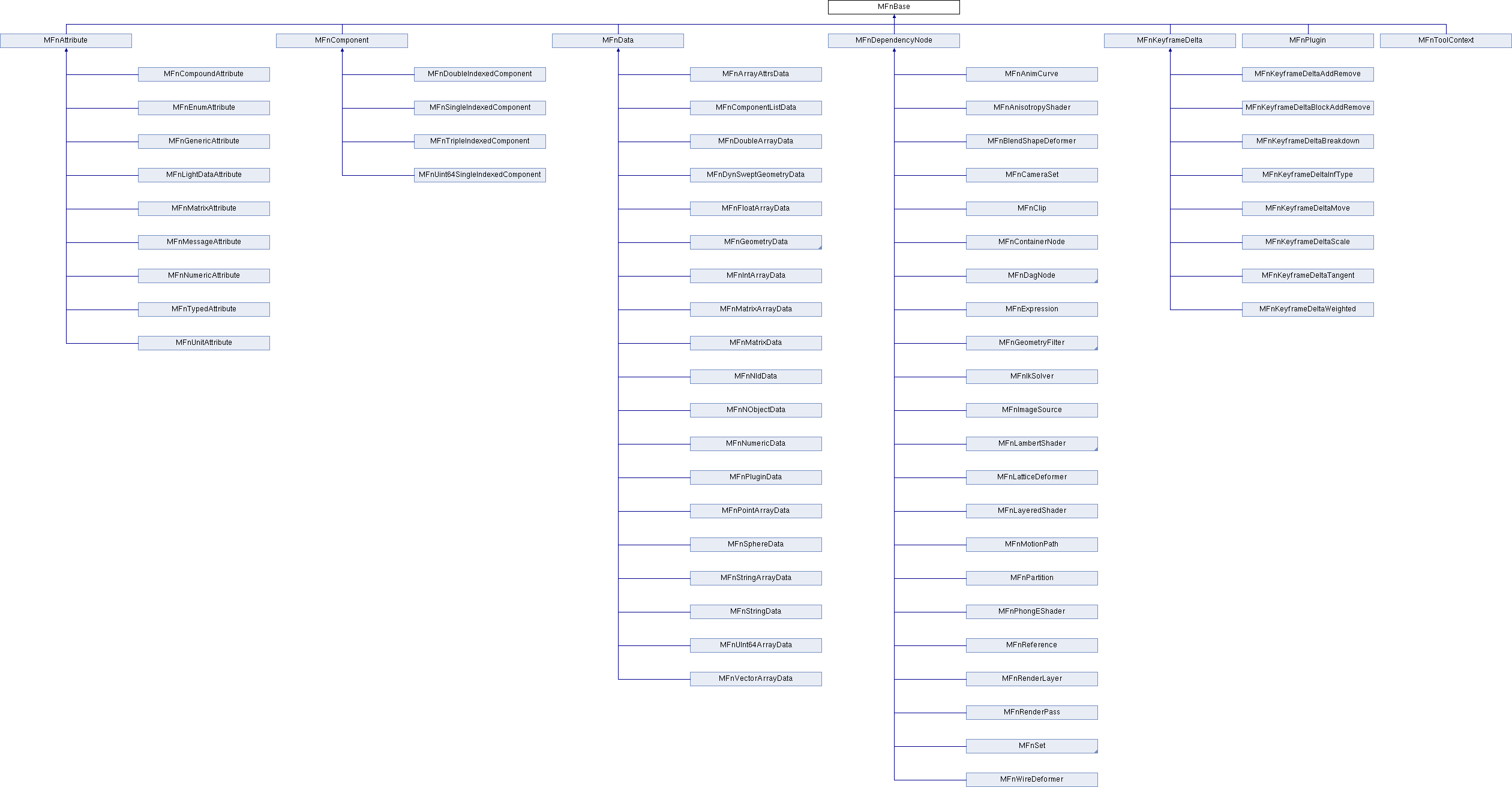

Inheritance diagram for MFnBase:Public Member Functions | |
