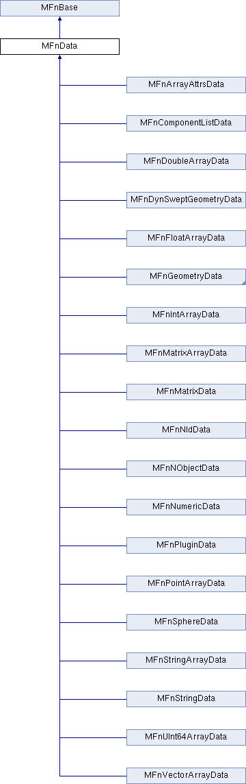

Inheritance diagram for MFnData:Public Types | |
