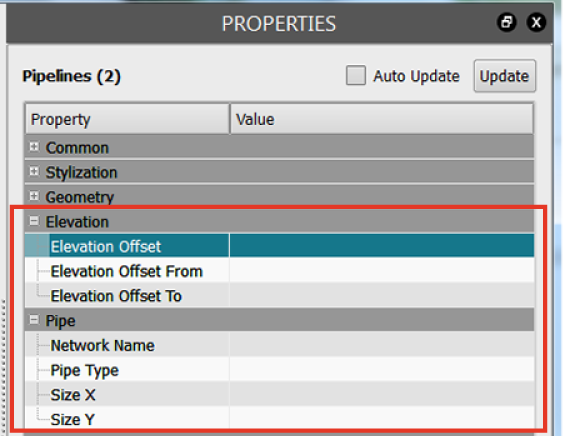

To adjust pipeline level using the Properties Palette
  1. With the entire pipeline selected, display the Properties Palette.
  2. To place the pipelines underground, enter a negative value for Level Offset.
  3. To assign a network to the pipelines for later use in AutoCAD Civil 3D, enter a value for Network Name, in the Pipe section.
