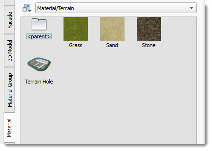

Assign a multi-scale terrain texture (Grass, Sand, or Stone in the Materials/Terrain catalogue) to a coverage area style for optimal visual results.
