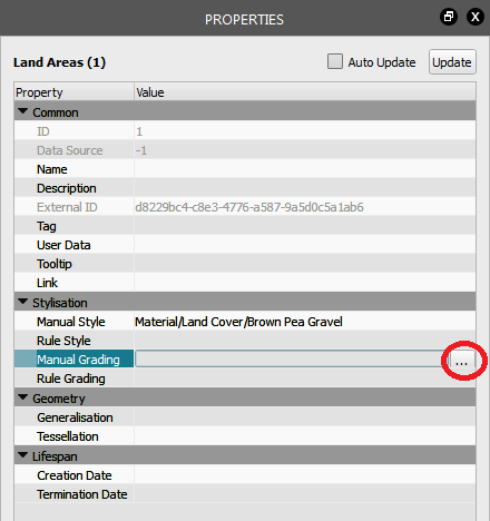

Alternatively, you can also apply a style to a Land Area by dragging the style from the Style Palette and dropping it onto the desired land area.
Land areas are a Surface layer in the Model Explorer and information about them appears on the Properties Palette. The number of land areas, as well as information (such as area) appears in the Land Areas section of the Proposals Manager.
