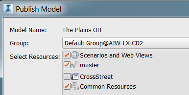

By selecting Scenarios and Web Views as resources when publishing or syncing the model, you can include the scenarios in the first publication of the model to the cloud or in subsequent syncs. This feature allows you to revise an available scenario but make the revision available only when it's ready.

- Sync the model.
