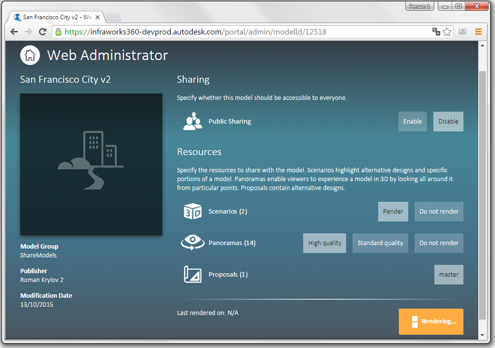

Web Administration Page
As an Admin or Publisher, you can:
- Render the model's scenarios or hide them from display at this time (Don't render).
- Render a model's panoramas for display, or hide them at this time (Don't render).
- Select the resolution quality of rendered panoramas: Standard (default), or High quality (3000 x 3000 pixels).
- Choose which proposal to render: Master (default) or one of its sub-proposals.
Note: Rendering larger models or ones with a number of panoramas or large scenarios can take a some time. You'll receive an email when rendering is complete.
