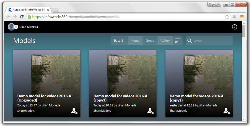

You can view pre-rendered versions of a model and its presentation elements (panoramas, scenarios and points of interest) in a web browser. You open a model from the browser view of InfraWorks 360 Home. Admins and Publishers manage the display of models and elements from the Web Administrator.
from InfraWorks 360 Home to access the web browser view of Home.
Note that tiles for models belonging to a collaboration group in which you're an Administrator or Publisher display the Web Administrator icon
. You can click the icon to open the Web Administrator page. See Preparing a model for viewing in a browser.
Clicking in a model's tile to open the model in your web browser.

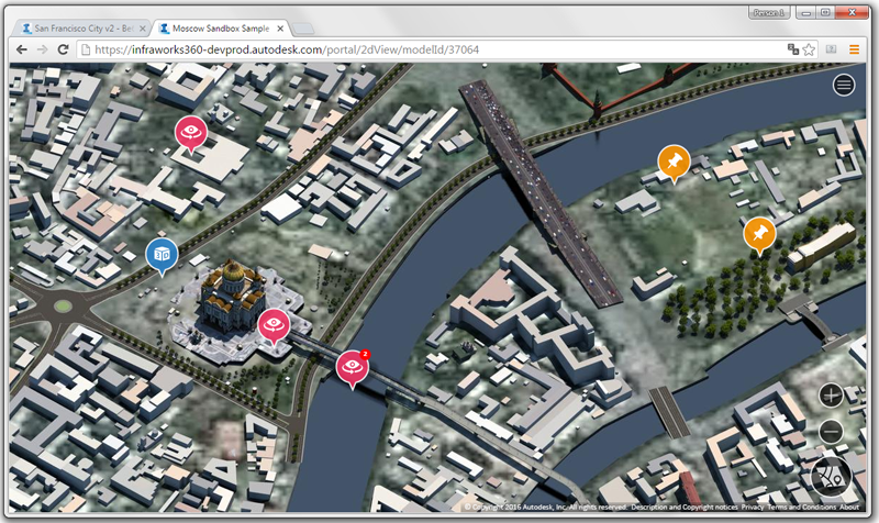

When you open a model in your browser it marks the location of rendered model elements:
Panoramas,
Scenarios,
, Points of Interest and
Clusters of these items that are located close to one another at the current zoom level. Click a cluster marker to zoom-in and see the markers in that cluster. Cluster markers also show the number of items in each cluster.

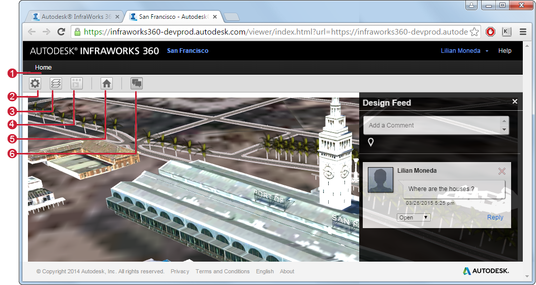

re-displays the browser view of Home.
toggles the display of scenario tiles.
toggles the viewing angle from a plane view and an oblique or "birds-eye" view of the model.
A panorama opens in a dedicated window. Operate the panorama using controls at the bottom of the window. Pan left or right, raise or lower the vertical viewing angle and return to the home position.
A scenario opens in a separate viewer. The viewer provides controls and custom settings for viewing scenarios, including playing storyboards included in the scenario.
Scenarios are presentation packages featuring a limited part of a model. A scenario may consist of a single screenshot or an elaborate, animation, created using storyboards. For better performance when viewing a scenario in a browser, it's recommended you limit the size and complexity of the scenario.
