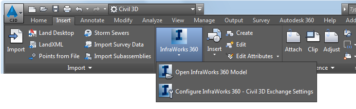

Autodesk AutoCAD Civil 3D users with InfraWorks 360 installed locally can open a InfraWorks 360 model directly in Civil 3D. An AutoCAD Civil 3D user can also bring InfraWorks 360 model data into AutoCAD Civil 3D by referencing an IMX file that was exported from a InfraWorks 360 model.
in the Open InfraWorks 360 Model dialogue. Do either:
To export InfraWorks 360 model data to IMX for use in AutoCAD Civil 3D, simply follow the general IMX export instructions, then close InfraWorks 360.

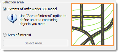

The Area of Interest option turns on the display of on-line map data in your AutoCAD Civil 3D drawing and enables you to select an area from the map. When you select an area of the map, the rectangle that forms the selection window acts as a boundary for the surfaces that will be brought into AutoCAD Civil 3D. Other objects, such as roads, that are inside or that cross the selection window will be brought into AutoCAD Civil 3D in full.
