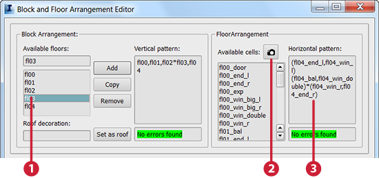

A Layout is a version of a facade. For example, you might have one layout for the front of a building and a different layout for the sides and back. The front might have doors, while the sides don't. To add a layout, click Add, just to the right of the Layout list.
A Block Sequence shows the elements of the layout, in the order in which they appear. For example, the Achilles style has a layout called Arrangement1. This arrangement has blocks called fl00, fl01, fl02+fl03. Each block is a pattern for a floor or a set of floors. The floors are listed in order, from the ground up.
Use a plus sign (+) if the pattern should appear at least one time and will be duplicated as many times as needed to create the facade height.
Use parentheses in combination with the plus sign to apply this to groups. For example (fl01, fl02)+ means that level 1 and level 2 appear at least once. If you raise the facade height, those two floors will be duplicated together.
1. Available floors are listed on the left, in the Available Floors list. The current arrangement of floors appears in the Vertical Pattern list.
3. The current arrangement of cells for the selected floor appears in the Horizontal Pattern list.
If you decide not to use that floor, delete it manually using the Delete or Backspace key. If the current style has a roof element, you can select it and click Set As Roof. If you decide you don't want to use the roof element, manually delete the entry from the Roof Decoration field.
The alert at the bottom of the list turns red if the syntax of the pattern is incorrect. This can happen if, for example, the commas are in the wrong place, or you have too many commas. Use the Delete and Backspace keys to correct the problem. As soon as you do, the alert turns green again.
