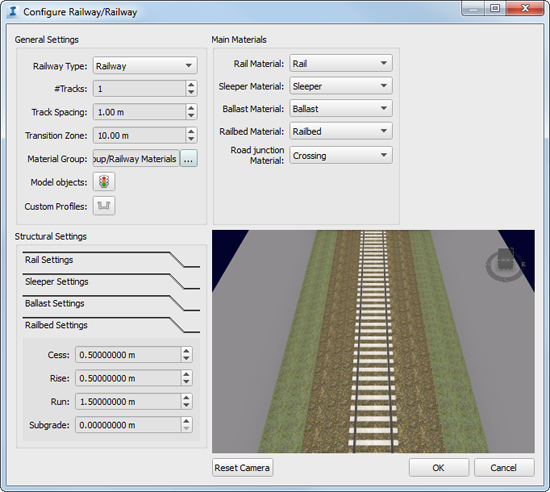

  5. Under General Settings, specify the following:
    Setting Description
    Railway Type
    Select Railway, Bridge, or Tunnel.
    #Tracks
    Changing the number of tracks updates the preview. This is a default value, which is replaced by any actual value for a particular feature when you apply the style.
    Track Spacing This setting affects only styles with multiple tracks (#Tracks = 2 or more). You can see the spacing adjustment in the preview.
    Transition Zone
    Defines the distance in which the terrain blends into either side of the railway. For example, with a transition zone of 9m, there is a 9m corridor to the left and to the right of the railway, where the terrain changes from its original height to the height of the railway. The larger the transition zone, the more gradual the terrain adjustment.
    Material Group
    The collection of materials and associated categories that map a material to the different parts of a railway style. You can define each component of the material group separately, from within its catalogue. See Edit Styles.
    Decorations
    You can add vehicles, vegetation, or other 3D objects as decorations on any single track of a railway. The style places 3D models relative to the centerline of the specified tracks. Decorations are automatically adjusted to avoid intersections.
    Custom Profiles
    You can add 2D profiles that smoothly follow the path of a single railway track you specify. Custom profiles use 2D cross-sections in SDF or SQLite format to create and display shapes such as guardrails, fences, or barriers.
  6. Under Structural Settings, specify the following:
      1. Railbed
      2. Ballast
      3. Ballast Run
      4. Ballast Width
      5. Sleeper
      6. Sleeper Width
      7. Sleeper Length
      8. Track Spacing
      9. Railbed Cess
      10. Railbed Run
    Setting Description
    Note: To view each group of settings, click its title.
    Rail Settings
    Specify the measurements for the flange, rail height and rail gauge. Indicate whether the rails are flush to the ground (no sleepers) or not.
    The flange must be set lower than half the sleeper's length and the rail gauge must be lower than the sleeper's length.
    Sleeper Settings
    Specify the measurements for the sleeper width (perpendicular to the tracks), length, height and spacing.
    Sleepers are called railroad ties in the United States.
    Ballast Settings
    Specify the measurements for the ballast area (the material between the sleepers). Specify the width, rise and run of the ballast.
    Railbed Settings
    Specify the measurements for the railbed area (the surface on which the railway sits). Specify the cess, rise, run and subgrade of the railbed.
    The cess is the part of the railbed outside the ballast area. It can be used as an area for workers to stand when trains go by, if it's wide enough. The run can not be greater than 70 degrees.
    The subgrade allows you to define the railbed width in a trough by modifying the height transition between the original terrain height and the grading width for the railway.
  7. Under Main Materials, specify the materials to use for the rail, sleeper, ballast, railbed and road intersection areas.
  8. If you're editing a railway bridge style, under Bridge Settings, specify the thickness of the bridge wall, the material for the bridge bottom and sides and the width, depth, spacing and material for the pylons.
  9. If you're editing a railway tunnel style, under Tunnel Settings, specify the height and thickness of the tunnel wall and the materials for the tunnel ceiling top, ceiling bottom and inner and outer walls.
