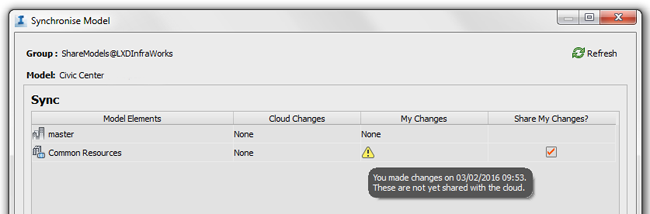

- In the Utility bar, click
Sync to open the Synchronise Model panel. You can hover over each My Changes icon to see when changes were made:
- Check Share My Changes if you want to include un-synced changes to the master or a proposal(s) in the current sync.
Common Resources are shared by the model master, proposals, panoramas and scenarios, bookmarks, themes and settings on the Model Explorer.
- Optional: Describe changes identifying this sync. This information is stored in Model History.
- Click Sync.
