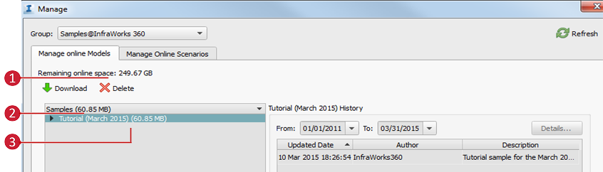

  1. On InfraWorks 360 Home, click to display a horizontal menu.
  2. Click to open the Manage panel, then click the Manage On-line Models tab.
On-line Model Information
  1. Total remaining space on the InfraWorks 360 account used to create groups under it.
  2. Total size of the models created under the current group.
  3. Size of each model shared by the currently displayed group.
Use the pull-down menu to display a different group.
The right side of the dialogue box shows the Model History. The history includes the date and time of updates, the author of uploaded changes and any description of uploaded change. If the description is long, click Details to view it in a larger window.
