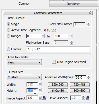

- In the Render Setup dialog
Common panel
Common Parameters rollout
Output Size group, set Width and Height to 512.
Each particle, or billboard, you generate from the particle system will be perfectly square, so the resolution of the map you want to use for the tree must be square as well.
A value of 1024 x 1024 or even higher is permissible, but the higher the resolution, the longer it will take to render the particle trees.

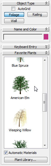

Create panel, activate
(Geometry). Open the Objects drop-down list, and choose AEC Extended.
- On the Object Type rollout, click to activate Foliage, then on the Favorite Plants rollout, click American Elm.
- Click anywhere in the Perspective viewport to place the tree.
- Right-click to exit object creation mode.

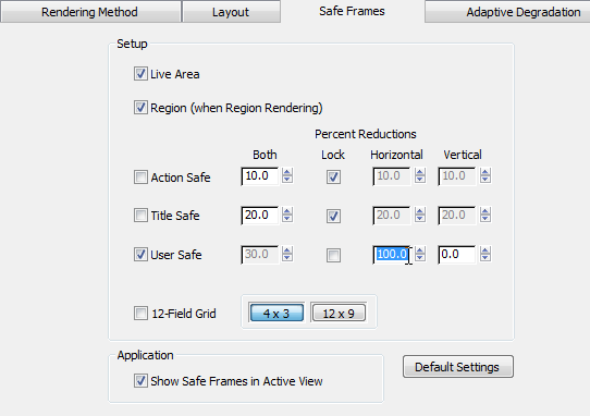

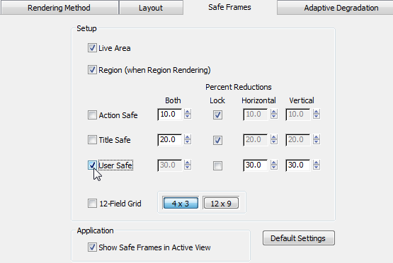

- Click the Perspective viewport’s General label (“[+]”) and choose Configure Viewports.
- In the Viewport Configuration dialog
Safe Frames panel
Setup group, turn off User Safe Lock, then turn on User Safe.
- Set the User Safe Horizontal spinner to 100.0, the Vertical spinner to 0.0, then click OK.
A purple vertical guide line displays in the viewport safe area. (This guide line is actually a rectangular safe-frame area that has no width.)

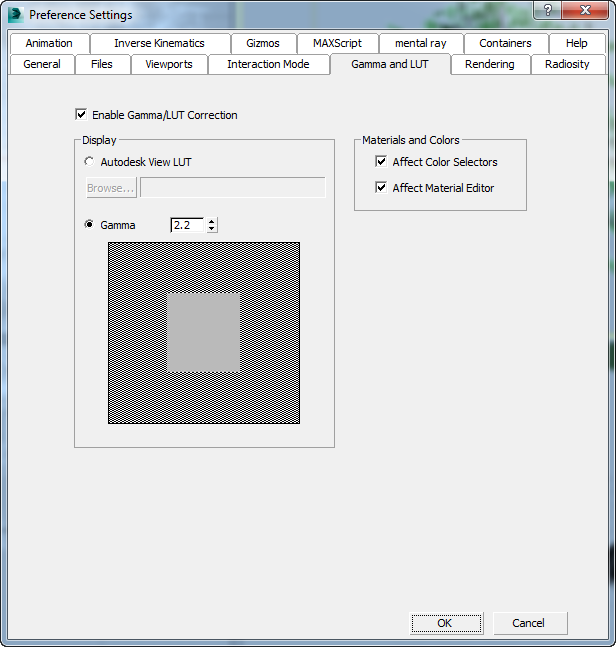

Render the tree:
- On the main menu, choose Rendering
Gamma/LUT Setup.
- 3ds Max opens the Preferences dialog to the Gamma And LUT tab. Make sure Enable Gamma/LUT Correction is on, Gamma is chosen, and that the gamma value is set to 2.2.
Make sure both options in the Materials and Colors group, Affect Color Selectors and Affect Material Editor, are on as well.
Adding gamma correction improves the appearance of renderings.
- Click OK.

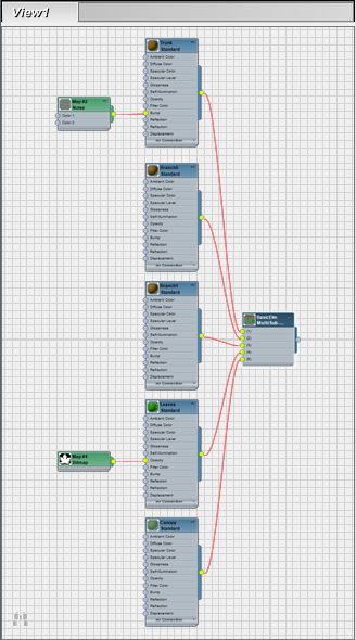

Change the material of the trunk:
- Open the
Slate Material Editor.
- On the Slate Material Editor toolbar, click
(Pick Material From Object), then in a viewport, click any part of the tree. 3ds Max displays the BasicElm material in the Slate Material Editor active View.
- In the Slate Material Editor, click
(Zoom Extents).

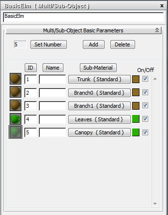

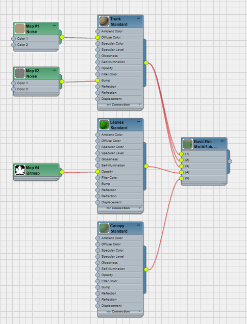

The material tree looks complicated because BasicElm is a Multi/Sub-Object material, but it really is not as complicated as it looks.
- Double-click the main BasicElm material node, the node at the right of the tree, so you can see the material parameters in the Parameter Editor panel at the right of the Slate Material Editor.
The Multi/Sub-Object Basic Parameters rollout shows how the BasicElm material contains five sub-materials, assigned separately to the trunk, branches, and leaves.
Note: The Canopy sub-material is the material shown in viewports when the tree object is not selected.

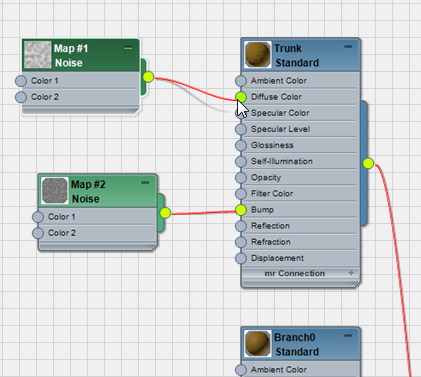

Now you will change the Diffuse values of the Trunk sub-material to improve the appearance of the tree trunk.

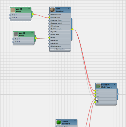

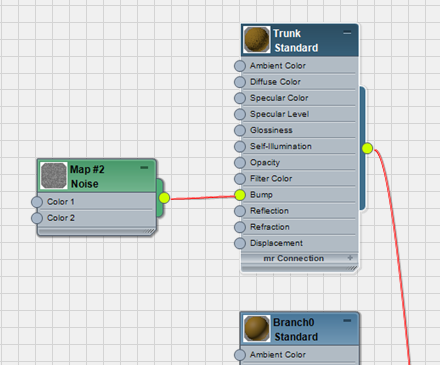

- In the active View, click to select the first sub-material at the top of the View, which is the node for the Trunk sub-material.
- Click
(Zoom Extents Selected), and then
pan out in the View a bit so you can see the Trunk material node and the map already assigned to it. When you’re done, right-click an empty area of the View to return to selection mode.
- In the Material/Map Browser panel at the left, locate the Noise map (it is in the Maps
Standard group), drag this entry into the active View, and then wire it to the Trunk sub-materials Diffuse Color socket.

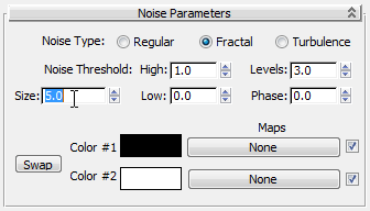

- Double-click the Noise map node so you can see the map's parameters.
- On the Noise Parameters rollout, choose Fractal for the noise type, and set the Size spinner to 5.0.
- Click the Color #1 color swatch and choose a medium-dark brown color, (such as R=77, G=41, B=5), then click the Color #2 color swatch and choose a light tan or beige color (such as R=146, G=124, B=102).

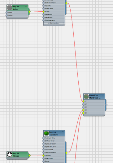

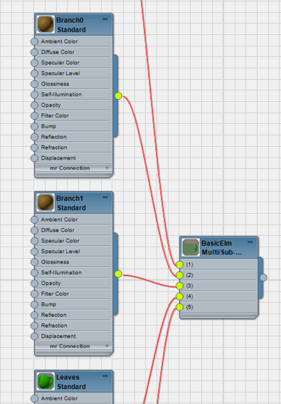

Use the new Trunk submaterial for the branches:
- Restore the Slate Material Editor window.
Pan downward in the View so you can see the Branch0 and Branch1 nodes. When you have finished panning, right-click an empty area of the View to return to selection mode.
- Click the Branch0 sub-material node, then press Delete.
- Delete the Branch1 sub-material node as well.
- Wire the Trunk sub-material node to the main BasicElm (2) and (3) sub-material sockets that used to contain the Branch0 and Branch1 sub-materials.
- With your cursor in the active View, press L to rearrange the layout of the material tree.
With only three sub-materials, the material tree is simpler than it was.
Now all the branches match the trunk, as you can see if you render the Perspective viewport again.

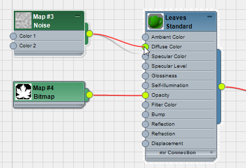

Change the material of the leaves:
- Double-click the Leaves sub-material node (now the second sub-material from the top) so you can see its parameters.
- Drag another Noise map from the Browser into the active View, and wire the Noise map node to the Diffuse Color socket of the Leaves sub-material.
Tip: After you add and wire the new Noise node, press L again to clean up the layout of the active View.

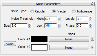

- Double-click the new Noise map node so you can see the map's parameters.
- On the Noise Parameters rollout, choose Fractal for the noise type, and set the Size spinner to 3.0.
- Also on the Noise Parameters rollout, set the Noise Threshold
High value to 0.7 and the Low value to 0.3.
These values will increase the level of sharpness between the two colors you are about to choose.
- Click the Color #1 color swatch and choose a medium-dark green color, (such as R=0, G=73, B=0), then click the Color #2 color swatch and choose a light green color (such as R= 175, G=189, B=171).

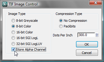

Save the “billboard” image of the tree in spring foliage:
- On the Rendered Frame Window, click
(Save Image).
- In the Save Image dialog File Name field, type my_elm_spring.tif, then click Save.
3ds Max opens the TIF Image Control dialog. In the Image Type group, make sure that 8-Bit Color is chosen, and Store Alpha Channel is on.
Note: You can save your file in a format other than .tif, but be sure to choose a format that stores alpha information. Formats such as .png and .tga can include alpha, whereas .jpg and .bmp cannot.
