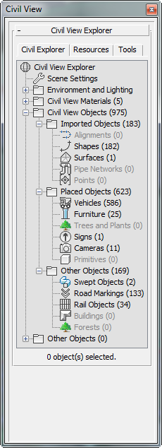

The Civil View Explorer is the focal point of the Civil View user interface. It provides an overview of the current state of a visualization, and direct access to the most commonly edited parameters of each object or other element in the scene.
The panel is divided into two distinct parts. The upper portion of the panel features a hierarchical tree view representing the entire contents of the visualization. This panel is constantly updated as the visualization scene develops, providing a full overview of the resources currently in use. As well as a fully categorized list of objects, the panel also provides detailed information about active materials and environmental settings.
The lower portion of the panel is known as the context-sensitive panel. This panel constantly reacts to your interaction with both the upper Civil View Explorer Panel and the main viewports. Context-sensitive rollouts are dynamically displayed in this area; these provide direct access to parameters relating to the currently selected element of the scene.

Civil View Explorer tab: Upper Panel
This hierarchical view of the model is automatically updated when you create, delete, or select objects. Selecting a single object in a viewport or an item in the hierarchical tree usually triggers the display of a rollout in the lower context-sensitive panel.
If you select a group of objects, the most appropriate parent item is highlighted in the hierarchy.
Although this panel provides editing capabilities only for single objects, certain parameters of groups of objects within the same object category can be edited using the Civil View Object Properties panel.
Clicking the right mouse button over any item in the tree opens a context-sensitive menu with choices relating to the selected item.
This panel shows objects that have been created both from within and from outside Civil View.
Primary Branches
The tree is divided into several primary branches, each of which represents a distinct aspect of the model.

Civil View Objects Branch
The Civil View Objects Branch provides a categorized list of objects that have been created in Civil View. The number of objects currently present in each object category is indicated in brackets after the main category label.
