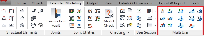

Advance Steel provides a complete range of tools, which are located on the ribbon, Extended Modeling tab > Multi User panel:
