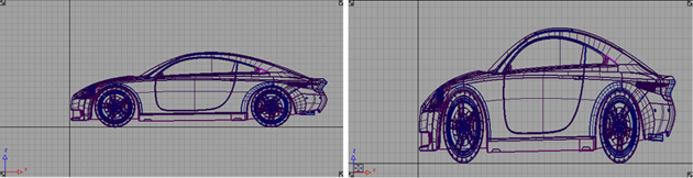

Non-proportionally scale the view
Non-proportionally scale the view interactively
  1. Make sure that Non proportional scaling box is turned off in General Preferences.
  2. Click in an orthographic window to make it current.
  3. Choose View > Set Non Proportional View.
  4. Drag the mouse to scale the view:
    • Drag the left and right to scale the view horizontally, and up and down to scale the view vertically.
    • Drag the to scale the view horizontally only.
    • Drag the to scale the view vertically only.
    You can also use the icon in the NavBar to non-proportionally scale a view in the Perspective window.

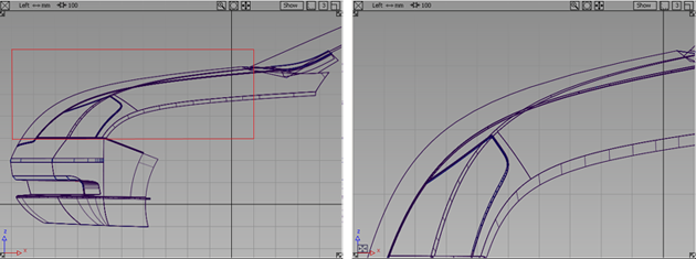

Non-proportionally scale the view by drawing a box
  1. Make sure that Non proportional scaling box is turned on in General Preferences.
  4. Click and drag to draw a box on the screen around the area you want to examine:
    When you release the mouse button, the window fills with the content of the box. This happens whether you drag right or left.
You can also use the icon in the Viewing Panel or the NavBar to non-proportionally scale a view in the Perspective window. The use of the mouse buttons is the same.

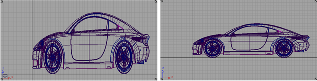

Toggle between proportional and non-proportional views
Once you have created a non-proportional view with View > Set Non Proportional View, you can use View > Toggle Non Proportional Viewto switch back and forth between your non-proportional and proportional view. No other aspects of the camera view are changed when using this tool.
Note:
A Non Proportional View icon is displayed in the lower left hand corner of the window when the view is non proportional.
When saving the file, both the proportional and non-proportional views are saved, and the toggle still operates properly after the file is re-opened. This is also the case when saving only the window layout with Layouts > User Windows > Save Current Layout and retrieving it with Layouts > User Windows > Retrieve Layout.
