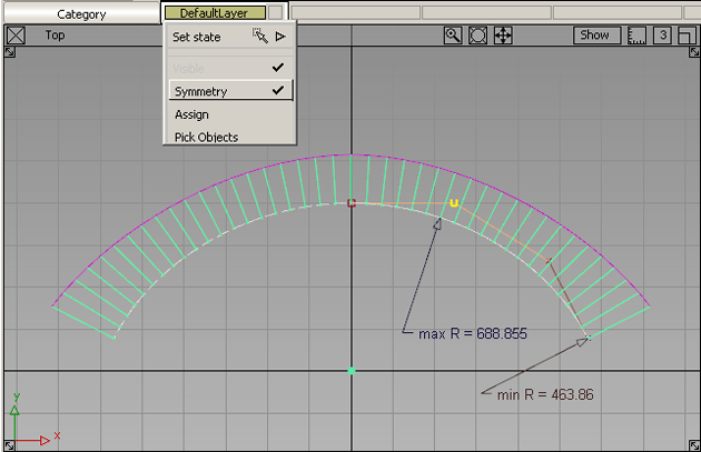

Add a curvature comb to a curve
  1. Choose Locators > Curve Curvature.
  2. Click the curves to which you want to attach a curvature comb. These can be free curves, curves-on-surface, isoparms, or trim edges.
    The curvature combs appear on the selected curves.
    If the curves are on a layer that has Symmetry turned on, the combs appear on the symmetric geometry as well. If Min Max Radius labels are turned on, they only appear on the original geometry.
  3. Drag the mouse to change properties of the curvature comb:
    • Drag the to change the scale of the quills.
    • Drag the to change the sampling density of the comb.
      Note:
      In orthographic windows, the curve curvature comb displays the curvature of a curve based on the planar projection of the curve that appears in that window. In perspective windows, the curve curvature comb displays the curvature of the 3D curve.
