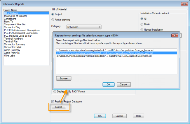

A format (.set) file preformats reports. A format file is specific to a report type, such as Bill of Materials or Component report. A format file defines the following:
Format files can be created in two ways.
When you run a report you can specify a format file to use.
If you do not specify a format file, the report's default format file is used. If no default format file exists, the report uses a format defined in the program. Use these tables to determine the default format file for a report.

When you run a report and select to insert it as a table, the program looks for an existing table for the report. If an existing table is found, the program updates the table rather than insert a new table. If an existing table meets all of the following conditions it is considered a match to the current report.
Since the format file is used to determine if the existing table is a match, you may need to create multiple format files for a given report type. This way you can insert tables for the same report multiple times, each using a different format file.

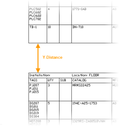

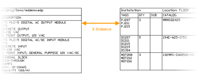

Breaks in a report table can be defined either by using the Special Breaks option or by defining a specific number of rows per table section. If your table contains breaks and multiple table sections per drawing, define the distance between table sections in your format file.
The X-distance and Y-distance values define the distance from the end of one table section to the beginning of the next. It is used when multiple table sections for one report are on the same drawing. A blank value is interpreted as zero.
