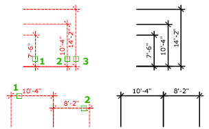

The spacing between parallel dimension lines is made equal. You can also make the dimension lines of a series of linear or angular dimensions line up by using a spacing value of 0.
Spacing is applied only to parallel linear dimensions or to angular dimensions that share a common vertex.

Applies a spacing value to the selected dimensions from the base dimension. For example, if you enter a value of 0.5000, all selected dimensions will be separated by a distance of 0.5000.
You can use a spacing value of 0 (zero) to align the dimension lines of selected linear and angular dimensions end to end.
Calculates the spacing distance automatically based on the text height specified in the dimension style of the selected base dimension. The resulting spacing value is twice the height of the dimension text.
