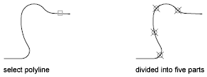

Select object to divide: Use an object selection method
Enter number of segments or [Block]: Enter a value from 2 through 32,767, or enter b
Places point objects at equal intervals along the selected objects.

The illustration shows an arc divided into five equal parts using a block consisting of a vertically oriented ellipse.
