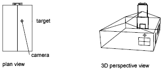

Defines parallel projection or perspective views by using a camera and target.
The following prompts are displayed.
Select objects or <use >.DVIEWBLOCK
Enter option
[CAmera/TArget/Distance/POints/PAn/Zoom/TWist/CLip/Hide/Off/Undo]: Specify a point with your pointing device, or enter an option
Specifies objects to use in the preview image as you change views. Selecting too many objects slows image dragging and updating.

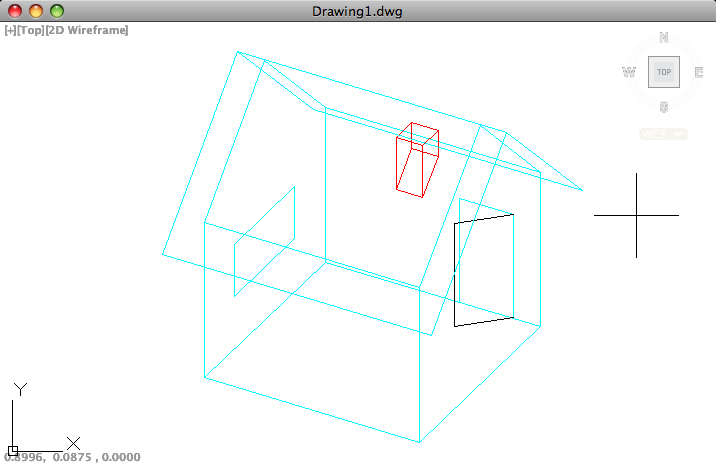

If you press Enter at the Select Objects prompt, DVIEWBLOCK displays a preview image. You can create your own DVIEWBLOCK block in a 1 unit by 1 unit by 1 unit area, with its origin at the lower-left corner. The following illustration shows an example of using the default DVIEWBLOCK to set the view (moving the graphics cursor adjusts the view).

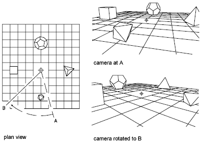

Specifies a new camera position by rotating the camera about the target point. Two angles determine the amount of rotation.
Sets the camera's position based on the specified point.
Sets the camera's position at an angle above or below the XY plane. An angle of 90 degrees looks down from above, and an angle of -90 looks up from below. A camera angle of 0 degrees places the camera parallel to the XY plane of the user coordinate system (UCS).
Switches between two angle input modes. Entering an angle at the Command prompt locks the cursor movement so you see only the positions available for that angle. Toggle unlocks the cursor movement for the angle, and you can use the cursor to rotate the camera.
Sets the position at an angle in the XY plane relative to the X axis of the current UCS. This angle measures from -180 to 180 degrees. A rotation angle of 0 degrees looks down the X axis of the UCS toward the origin.
The illustration shows the camera rotating to the left from its initial position, leaving its angle from the XY plane unchanged.

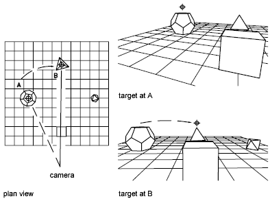

Specifies a new position for the target by rotating it around the camera. The effect is like turning your head to see different parts of the drawing from one vantage point. Two angles determine the amount of rotation.
The illustration shows the effect of moving the target point from left to right, leaving its angle from the XY plane unchanged.

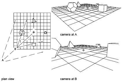

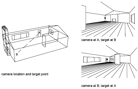

Locates the camera and target points using X,Y,Z coordinates. You can use XYZ point filters.
To help you define a new line of sight, a rubber-band line is drawn from the current camera position to the crosshairs. You are prompted for a new camera location.
A rubber-band line connects the target point to the crosshairs to help you place the camera relative to the target. The illustration shows the change in view as you swap the camera and target points. Lens and distance settings are the same in each case.

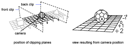

Clips the view, obscuring portions of the drawing that are behind or in front of the front clipping plane. The front and back clipping planes are invisible walls that you can position perpendicular to the line of sight between the camera and target.
Obscures objects located behind the back clipping plane.
Obscures objects located between the camera and the front clipping plane.
Turns off front and back clipping. If perspective viewing is on, front clipping remains on at the camera position.
