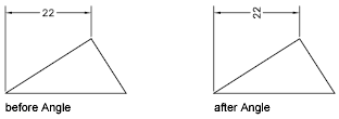

Changes the angle of the dimension text.
